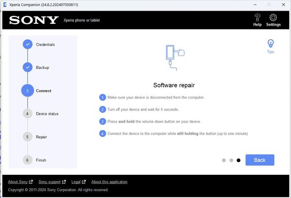

Hi,
Thanks for your very sensible suggestion.
I downloaded the Xperia Companion as you suggested but unfortunately it failed to connect, it got stuck on this screen.
I can't turn off the phone using the power button, the only way I can turn it off is to take the battery out and then refit it. Other than that I am following the instructions to the letter.
I wonder if that might be causing the connection problem.

Hi again, I have managed to connect now (I was connecting through a USB Hub before).
Unfortunately the new error message says this model is no longer supported.
I'm guessing the best this to do know is bin it.
Thanks again for trying to help.
