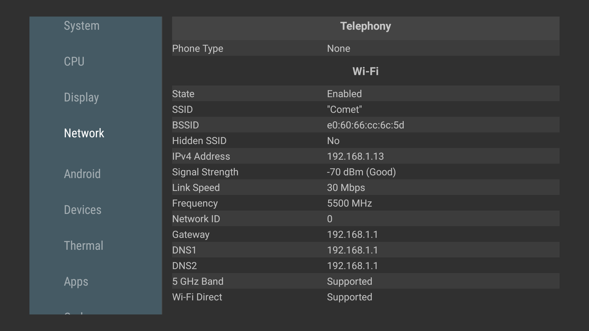

Yes, we are talking about the same indicator, then. My values are totally different. While my MacBook has a transmission (link) speed of 200-300Mbps, the TV, at the same time, today has reached values like this:
And now it is oscillating at 90-120Mbps (usually it stays at 1080Mbps, as I wrote earlier). Not sure why some days it must fall down in this way. As I am not sure why the WiFi must connect via USB2! This SoC is a joke.

Signal strength -53 dBM @10 ft from WiFi router
Link Speed 866 Mbps
Frequency 5180 MHz
connected on TP-Link Archer VR900, 5 GHz band
Laptop at same distance and with Intel dual band wireless AC3160 @5GHz has a Link speed of 433/433 Mbps
