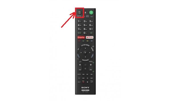

There are multiple ways to change the input source, but there is a button on the remote control, see pic below:
You can also press the [HOME] button on the remote control and on the home screen you should see the inputs to select:
