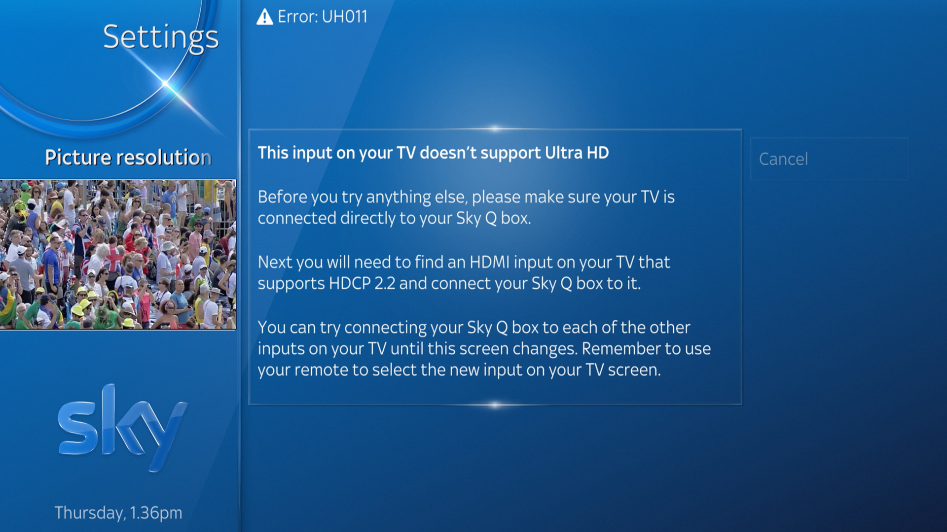

Have tried to turn on SkyQ 2160 resolution, with my Sony KD-55X8505B connected, but just get a blank screen which then resets back to 1080 HD. This happens for both 10-bit and 8-bit colour settings and for all 4 HDMI inputs. On the SkyQ box I get the error message UH031 for HDMI inputs 1 & 2, and error message UH011 for HDMI inputs 3 & 4.
My understanding is that HDMI inputs 1& 2 are the only ones that support HDCP 2.2. The error message for HDMI inputs 3 & 4 I think relates to a problem with HDCP 2.2 being absent.
