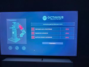

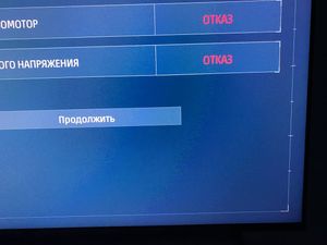

I have some problems with connection my TV Sony XR-65X90K and RTX 4080 through HDMI.
I tried to connect cable to all the HDMI ports, but it doesn't work. Furthermore, I tried to change HDMI mode on HDMI ports and it gives some result. Sony HDMI modes:
  • Standard - doesn't work
  • Enhanced - doesn't work
  • Enhanced (Dolby Vision) - doesn't work
  • Enhanced (VRR) - works, but the picture isn't perfect.
If I use the VRR HDMI mode on TV, I have a picture, but:
  • I can't use full screen mode when I play games.
  • VRR mode disables Local Dimming.
  • The picture has a washy and faded picture.

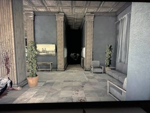

  • Some games, for example Outlast, have graphics artifacts in shadows.
  • HDR looks like it doesn't have enough brightness.
It's just beyond frustration when you buy a quite high-end TV, you paid a lot of money for all the cool functions and modes BUT it works only in one mode and not even as it should work.

I add photos with issues.
HDMI modes:
Game Outlast has graphics artifacts:
photo_2023-02-09_10-18-37.jpgphoto_2023-02-09_10-18-37.jpgphoto_2023-02-09_10-18-33.jpgphoto_2023-02-09_10-18-33.jpg
Broken color depth:
photo_2023-02-09_10-18-30.jpgphoto_2023-02-09_10-18-30.jpgphoto_2023-02-09_10-18-24.jpgphoto_2023-02-09_10-18-24.jpg
